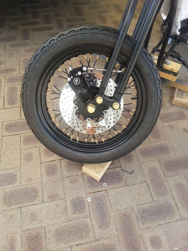

Fitted up a 2-Piston Performance Machine caliper. Just needed to fit a few spacers behind the brake disc to give the caliper some clearance on the back so it was clear of the spokes. Off to get some proper spacers machined up for it now rather than the flat washers I used for the trial fit up.
