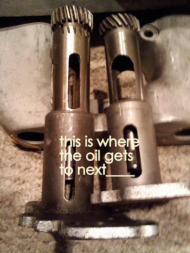

if we slow down now and think we get to this- in order for the pump check to leak, oil has to get to the tank side of pump check. in order to get there its gotta sneak past gear clearance in pump. whitch it obviously does. but is the only place this errant oil can go? hell no. on way to check it finds clearance here
where the breather valve fits thru the upper oil pump housing.
where it leaks into the space between breather sleeve and housing exiting at the first place it can. the bottom of slot in upper housing.
here
now its filling the breather passage that leads to crank case. this passage is located lower than the floor of cam chest.
so oil is now filling the crankcase not the cam chest. the factory made sure that it happened like this. they wanted this unchecked oil to stay out of the cam chest. so your bike is less likely to puke.
