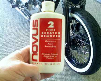

Powdercoating will not polish out like regular enamel paint because it's basically plastic. However, I found that NOVUS 2 fine scratch remover for plastic works really well. My derby cover is powdercoated "wet black" (as are all the other black parts on the bike) and since I have mids my boots or shoes rub against it and scratch/scuff the powdercoat. They almost disappear when I rub them out with this stuff. I used to use it on my sport bike windshields, and helmet face shields. I think you can get it at just about any auto parts store.
I've got a couple scratches on my powder coated tank (gloss black). I got the novus kit. Do you apply by hand or on a buffing wheel?
thanks!

Meguiar's makes a lot of different "stuff" what exactly do you use? I have already tried #9 swirl remover, nothing.
I am thinking the plastic polish recommendation is the way to go.
