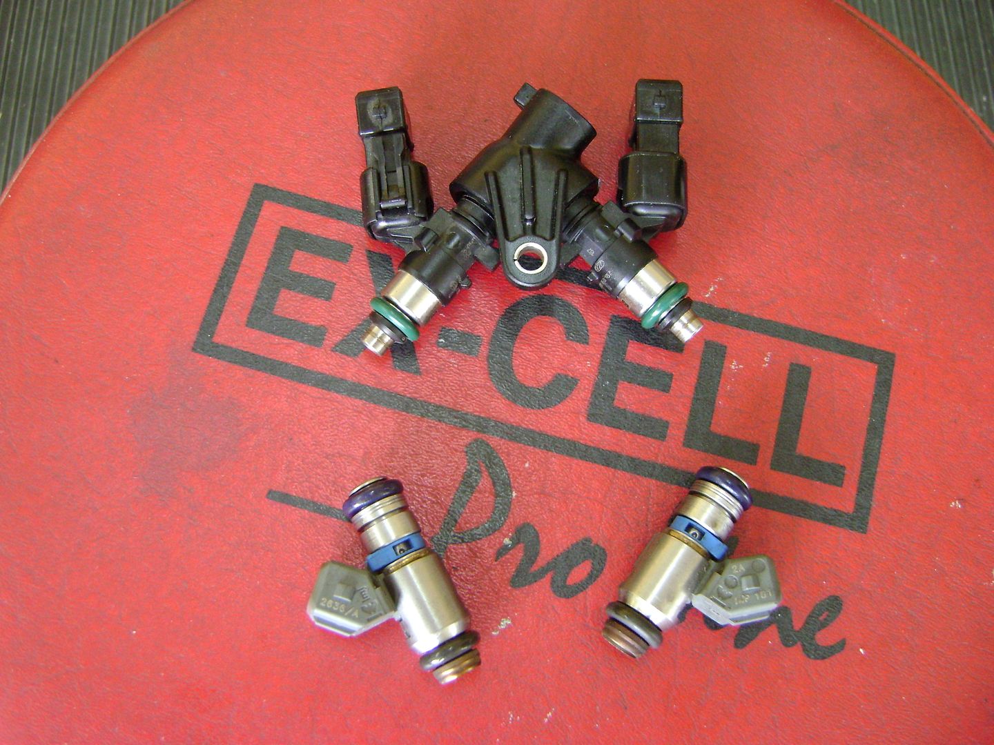

I check today data logs from my thundermax...look like on 6800-7000RMP my injectors work at 90% duty cycle :/
I def. need bigger injectors !!!
anybody known that this :
PN 27796-08 SE injectors 5.3g/s
or
PN 27797-07 SE injectors 4.9g/s
or
PN 27665-01A V-rod stock injectors 4.81g/s
will fit to 2007 sportster ?

Kot - It looks like you are basicly going to be running a dry nitrous system. For small shots I think your timing will be just fine as it is n/a. Just start small and listen/check plugs after a run. A cold bottle won't be worth a damn...gotta heat it up to at least 900psi...a hair dryer will work in a pinch on a small bottle. Maybe fatten up afr's at WOT if needed. The ideal solution would be to use a progressive controller...I have one here I might experiment with at a later date.
If possible use teflon paste intead of tape...tape often flakes and plugs the small orifices. You might try at first just activating in fourth and fifth gear to get a feel for it...maybe use the horn button along with a WOT microswitch.
Yes, I will use dry system , but with thundermax I can add extra fuel
with stock injectors only when I ran with nitrous . The same thing with timing , 25deg only with nitrous and auto activatad nitrous only on WOT and above 4500RPM...
My problem is that my stock injectors are too small , my engine make ~100HP
on 6000RPM injector duty cycle is above 80% on 6800RPM injectors work on 90% ! Injectors shouldn't run above 80% duty cycle...
It doesn't matter what I do , change the tune for fat AFR or spraying nitrous direct to air temp sensor , ECM will try add the fuel but injectors will can't do that .
so anybody know that
or
or

Let's ask Jason about the injectors he has been using in our turbo's...they are from a turbocharged Volkswagon. He can tell you what the values are specifically and if any of those you listed are comparable. I'll message him and send him to your thread.

They are a 6 hole pattern, no shrouded nozzles, the spray plates are custom drilled so each set of 2 are flow matched. They start at what HD would rate 6gs and I've ordered as big as 8gs... I'd have to check records but Ricks are 6 or 7, all the turbo 1200 bikes are 7gs....
The lil Ports help them tune out real clean...hell people would prob tell you you'll never get 6 or 7gs Injectors to drive nice low end on a lil 883...
