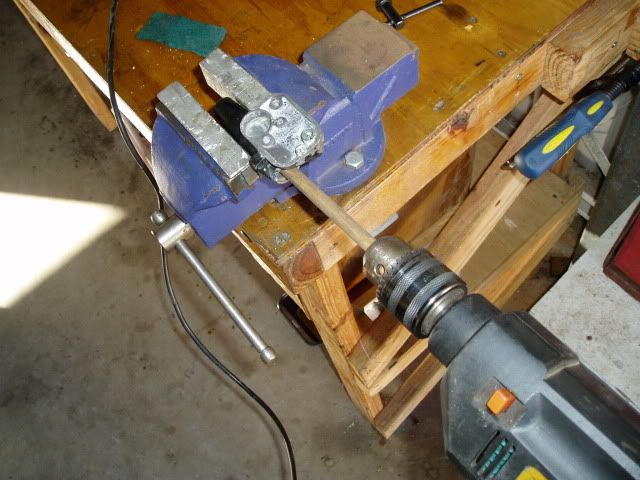

Default Poboy's brake cylinder hone
I reckon this zero-cost brake cylinder hone works better on small motorcycle master cylinders than the proper tool you buy at the autoparts store. It fits inside 13-15 mm mastercylinders much easier and does not fly apart and scar up the aluminum cylinder bore.
I have been using this one for 30 years and have not worn it out yet.
The heart of the machine: a piece of 3/8" wooden dowel about 8 inches long.
With a hacksaw cut down one end, about 3/4" long.
A piece of 800 grit wet rub paper folded double and placed in the slot.
Roll it round so it matches the direction of rotation of your electric drill, so it goes with the flow, not against it.
Hold master cylinder firm but dont crush or distort it, and insert the special tool.
Fire up the electric drill. The faster you spin it, the more the wet rub paper is flung out against the cylinder. Check the bore frequently as it rapidly removes the soft aluminium so it does not take long to get the cylinder nice and smooth again.

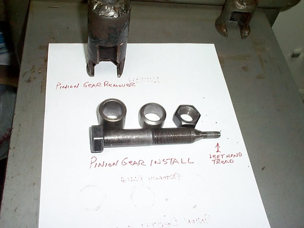

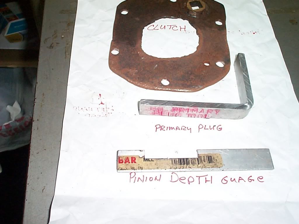

here are a couple of pics.
most of the time i make what need from scrap laying around the shop and return the tools to the scrap pile to reduce clutter. use fine thread, use hardened washers and i perfer 7018 rod.
