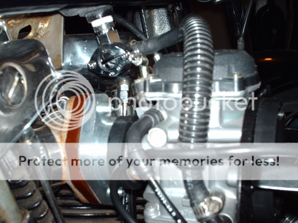

If you want a CV, that's the style you want. 40mm w/an acc pump. If you can find an unmodified one with the welch plug covering the idle mixture screw (IMS) still in place, that's even better. That way, you can be fairly certain the PO hasn't borked up the IMS seating surface, at which point the CV is an interesting paperweight. A drilled slide is also something to avoid, as are lighter slide springs.
Three common ways to mount.
(1) Mikuni metric adapter.
(2) Press on adapter.
(3) Non press adapter. Requires stock CV seal.
Option (3) is the route I chose. I didn't like the idea of the permanent mount and seemed more elegant than (1). As others have said, there are different things you may run into, throttle, petcock clearance, etc. For me, coming up with an internal, single wire throttle was the most difficult. The original 180º petcock had to be replaced by a 90º petcock. Others have reported clearance issues with the latter. YMMV.
Here's a shot of mine mounted.
this is the same way wilsons is done.Except there is a 90degree pipe elbow exiting the fuel tank , the push portion of the cable holder was clipped off to clear the pipe elbow for the fuel and the stock CV pull throttle hooks right up nicely and functions well. maybe wilson will post a few pics on here of it. I know his bike very well.!!!!!
Your friend Zack.

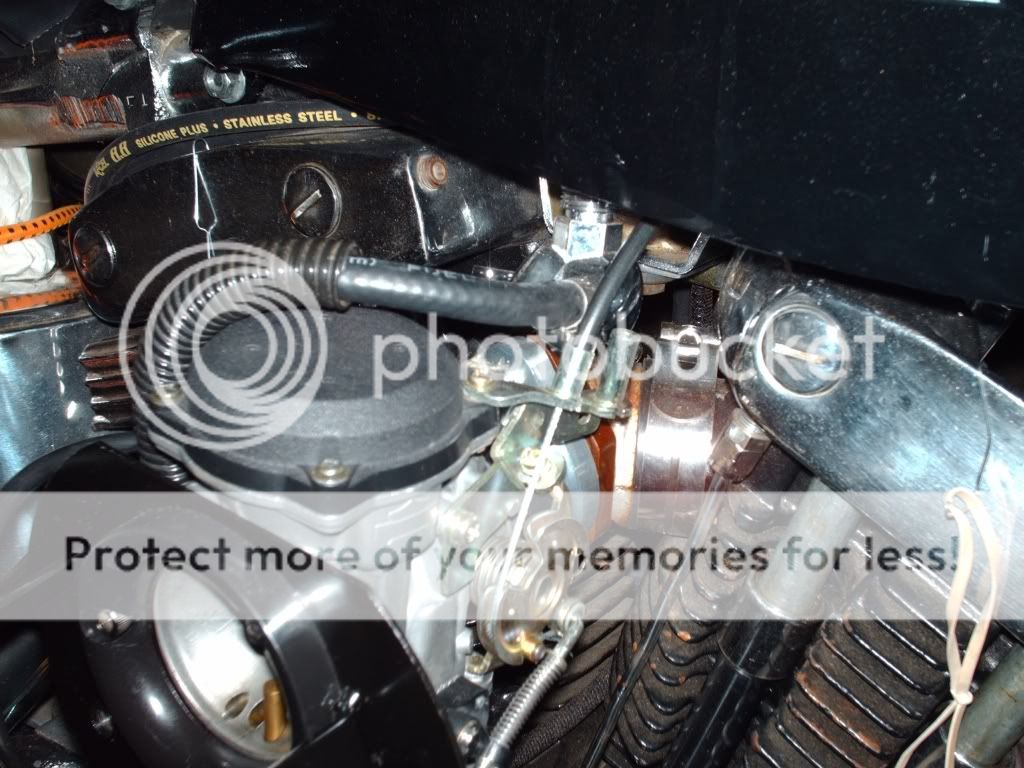

Single wire here as well. The return cable holder could be removed without issue, but it wasn't a clearance problem for me.
The other side.
