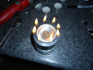

here is my diy tuna can warmer, penny stove with base, snow peak cup that holds 2cups for single pot recipes and coffee can to store food.

the penny stove on the right is what i use for boiling water. it runs off rubbing alcohoal or heet. it is made of pop cans so if you lose it no big deal, once you learn how to make one you can duplicate it with minimal tools and resources.

the penny stove in action, on 1/4 ounce rubbing alcohoal it will burn for 4-5 min, boil 1 cup of water in 3-4 min. using a 5 hour energy bottle i can store 2 oz of fuel.

Can your penny stove simmer?
my butane can or boil .5 litter water in 7 minutes
the multy fuel can do it depending on what fuel can do it in 10 min

that is one of the drawbacks to it, no control over the flame. fun little project i found that was easy and cheap to make. i found an extra use for it, by polishing the bottom part of the can you can use it as a signal mirror for help, and like a magnifying glass to direct sunlight onto timber for a fire starter.
