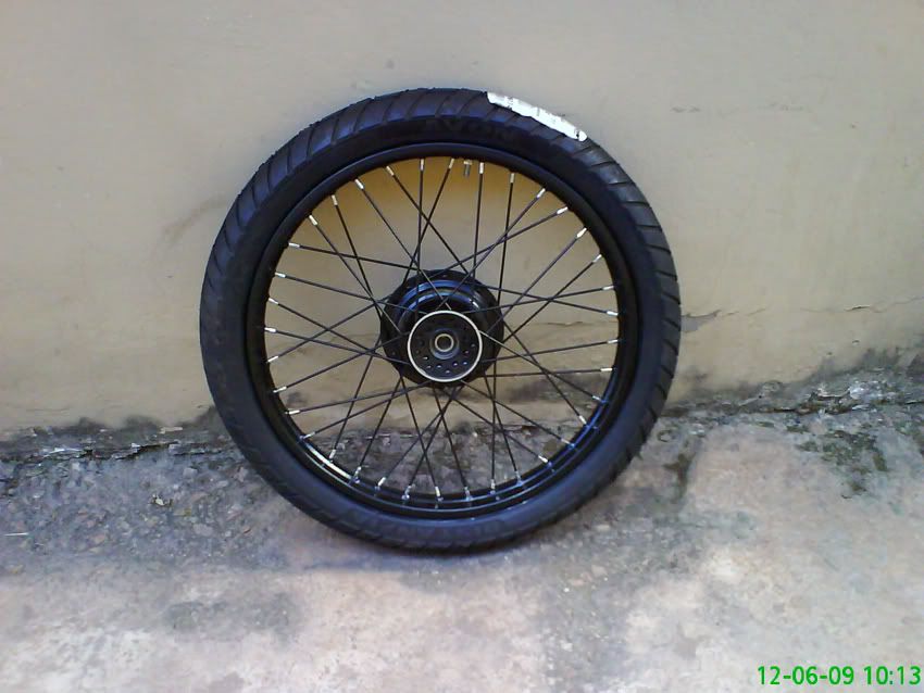

I'm sorry I haven't been around for a while but I made some sort of progress. My front wheel is coated, laced and I had a new Avon Venom tyre fitted. I'm waiting for the rear hub to come back from powdercoat and we'll get the sucker built. I tried all sorts of moves on the rear hub that never worked so I machined the hub to take bearings for the 1" axle. That's the route I should have taken in the first place. I'm my own worst enemy all the time. I'll post pics of my rolling chassis next weekend but here's two of the front wheel.
