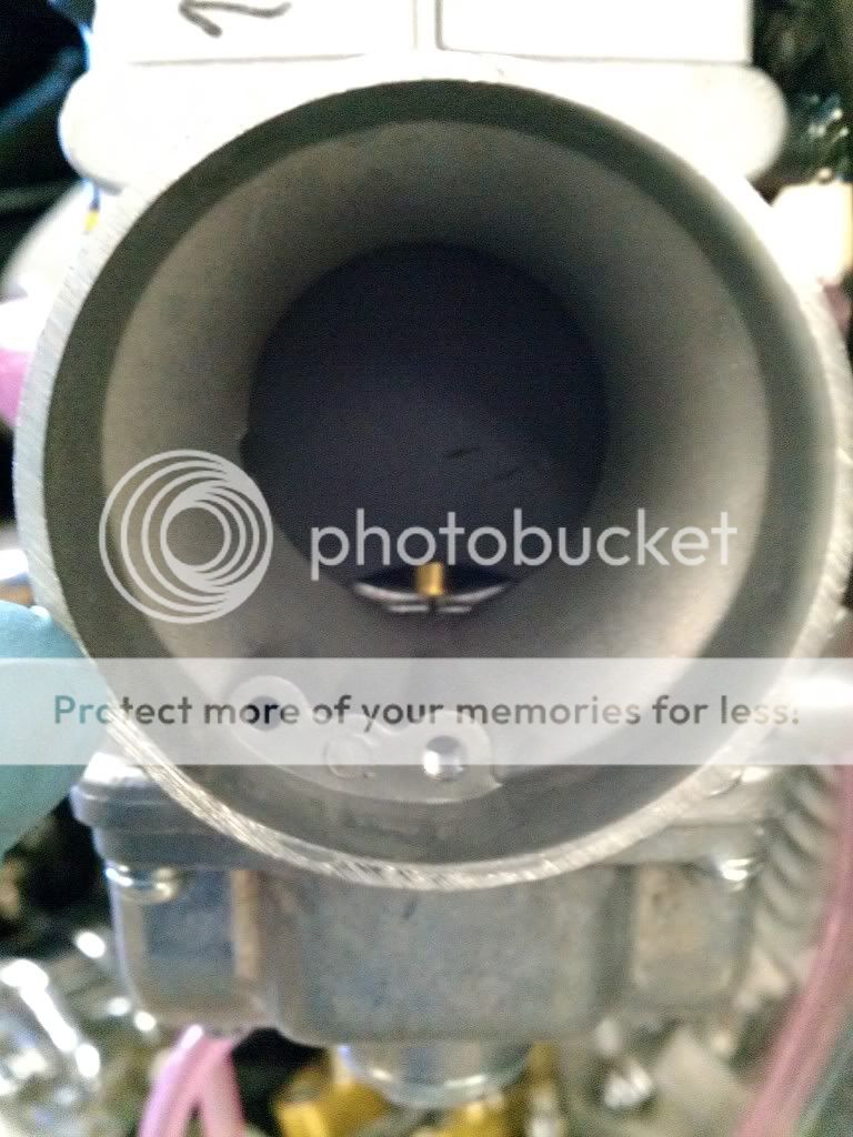

Originally Posted by KRTTXRTT View Post
Once I figure out how to post pictures, I will shoot a pic of mine. I have two sets that are Branch modded and they differ. One set has a larger 40.5 mm venturi and has an external sleeve. The other set has a tapered venturi and is closer to yours at 39.5 mm.
Here is a Branch Carb bores and blended (also has a 55mm long velocity stack), the center hole at 7:00 is epoxied
And the factory 38mm carb, the hole plugged w/ a piece of aluminum in the stock 38mm.
The design of the carbs are different now.
The new Mikuni design has a idle adjuster in the side of the slide housing.
The earlier style has the idle adjustment in the slide cover w/ the funky rod and jam nut.
The slides are different as are the slide guides(blocks) and the slide covers obviously.
I will get more photos showing this.

Im still having trouble w/ setting up new dual 38mm flatslides for 0-2000 rpm.
I have a set if Branch 39.5mm (38's bored).
The 39.5's have 30 pilots and 300 mains w/ 6dp4 needles.
The 39.5's work flawlessly through rpm range.
I cannot seem to get idle/ pilot circuits to work well in the 38's.
If I tune idle circuit w/ 15 pilots the transition to mid range suffers.
If I run larger pilots to compensate the plugs foul.
Now I notice the small bypass hole (just behind needle jet) coming from up from the pilot circuit into the bore on the 39.5's is about twice the size (.050")of the stock 38's (.025")
If I enlarge this hole, I'm thinking it will add more air, then I can run a larger pilot.
Any details appreciated.
Here is a photo of the bypass holes in question,
its the small holes behind the brass needle jets.
The carb on the left is new 38mm, right is the modified 39.5mm Branch.
