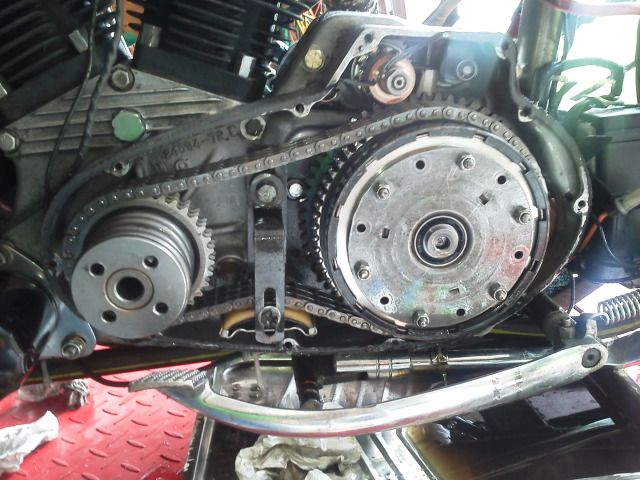

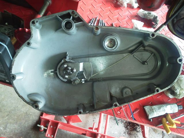

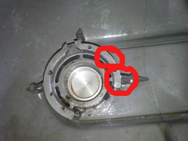

Opened my clutch today and found two issues. My ball and ramp assembly was hanging up on my clutch cover so I wasn't getting a straight in and out push. I also found that my clutch springs where 3/8" too short. So I think a little cover grinding is in order and new springs as well.
I'll post pictures when I get to work.

ok, here are some pictures
Inside of my clutch cover
My primary
These next two show where the actuator was rubbing just on the right of where it sits.
Am I right in thinking I can just file it down a bit until the rap clears it?

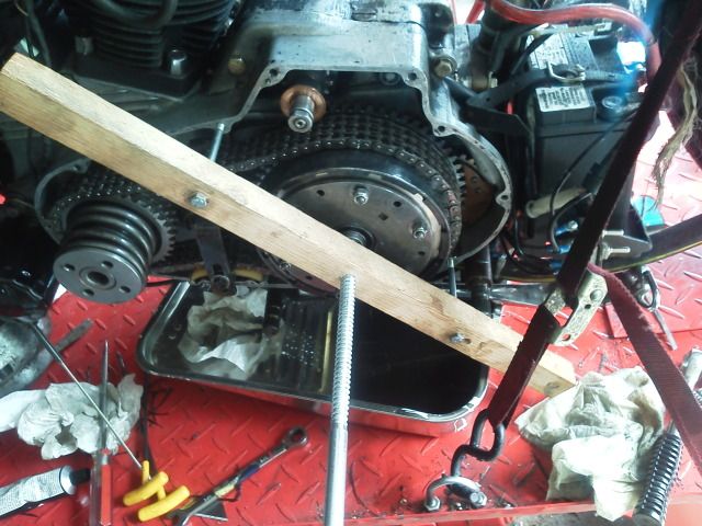

my home made clutch compression tool

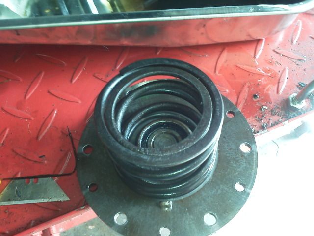

My springs that were 3/8" too short.

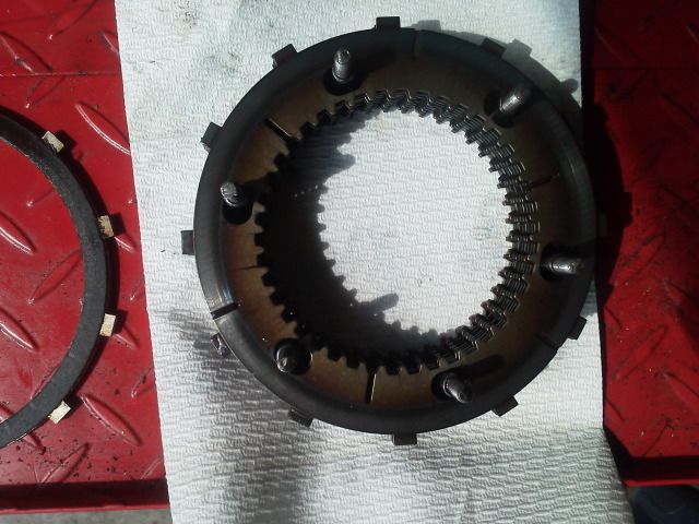

my clutch pack. a little toasty from the slipage it was having
a fiber plate, doesn't look bad, but I went ahead and upgraded to kevlar fiber plates. I was thinking it couldn't hurt, and might deal with my 1200cc stroker and R5 cams better.
Im thinking the main problem I was having was the springs just where not putting enough pressure on my clutch to get it to grip, and I am sure that the ramp not going straight in and out wasn't helping.
