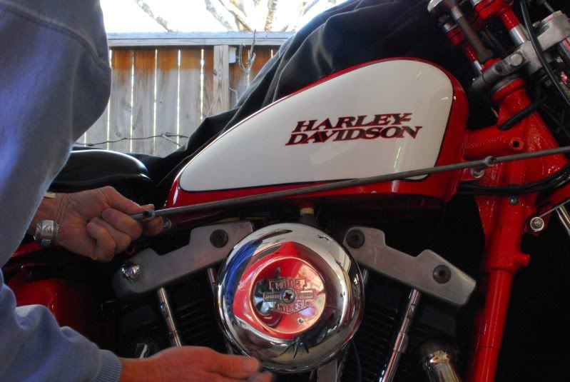

Here is a pic of my wiring going into the top right hole on my 1971 XLCH..................................
You can see the shrink wiring bundle entering the hole on the right side of the pic.
The wiring is run inside the top tube and exits at the rear under the seat.
After exit of the frame tube, these wires connect to a small panel board (4 or 5 connections) and from the panel board the wires are run to the horn and other places that are required on an XLCH and XLH.
