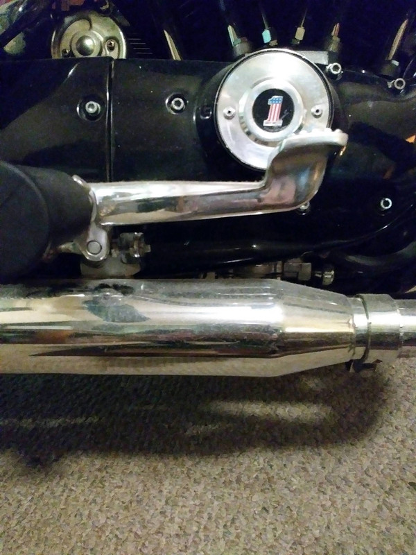

  #492
60weight's Avatar
60weight 60weight is offline
Posts: 2,411
Sportster/Buell Model: XLS
Sportster/Buell Year: 79
Sportster/Buell Model #2: XLS
Sportster/Buell Year #2: 82
Reputation: 69726
60weight has much to be proud of60weight has much to be proud of60weight has much to be proud of60weight has much to be proud of60weight has much to be proud of60weight has much to be proud of60weight has much to be proud of60weight has much to be proud of60weight has much to be proud of60weight has much to be proud of60weight has much to be proud of
Thank you Rok
Heres a pic

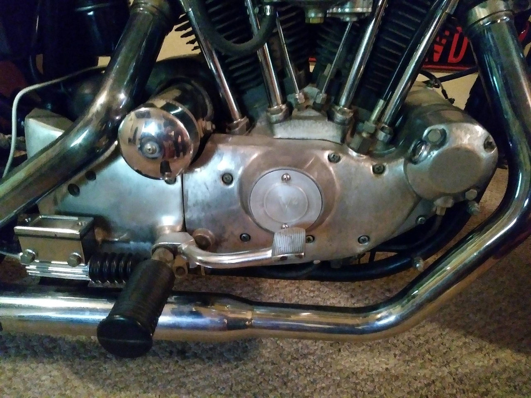

  #493
60weight's Avatar
Posts: 2,411
Reputation: 69726
Another a bit embarrassing cuz no cleaning done yet.
But Ya see getting to stuff is easy without crossover....teasing,I know your keeping Her all factory.
