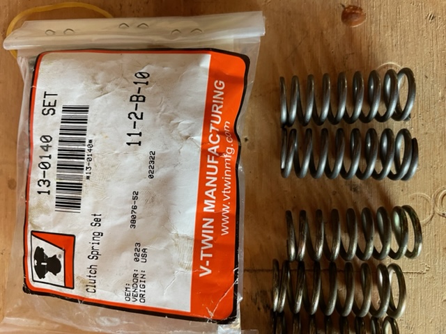

Thanks to you all... I am finally getting everything back together... even put the primary case cover on without putting the friction plates in ;-)
I will finish everything tonight and ride for the first time (I hope) but I wanted to share a few things already regarding the springs I replaced on the pawl carrier and clutch.... I tried to take the picture with the old and the new shown, though the differences may not appear big on the images
Pawl Carrier Springs, got the replacements from Denniskirk... left new, old on the right...
Cam follow spring, got replacement from JP, new one is in the bag
shifter pawl spring, denniskirk again... you need two of these...
clutch springs from JP, probably not too much of a big deal to find... however, kinda roughly manufactured...
I would suggest you install them.
The FSM calls for having the distance set from the spring cup to something like 3/16ths (I forget and don't have my FSM here.
I can't remember if they tell you to "get the plates even", or however you describe this. But the idea is to have the pressure plate lift evenly. all around, when you pull the clutch in. Try to get the plate to lift as evenly as you can.
The clutch lifting mechanism on the Ironhead wasn't great right from the start. There's not really all that much "lift" in the mechanism. If the plates aren't lifting evenly you will get some frag. That's not good.
The clutch pressure plate is a weak link as well. That little slot the clutch push rod end fits into is prone to breakage, Probably because it's too thin and flexes as you pull the clutch in.
The stock dry clutch on the 900's was the best in the business when introduced. 60 years later it was still working for the XR750's putting out over 100 HP.

Thanks Ferrous Head... in fact... my pressure plate is bent a bit... I have ordered a new one but it doesnt come in for a few more days...
I put the old one in for the time being .... works fine after messing with the hub stud nuts a bit...:-)
FSM says '3/16 from inner surface of tension adjusting plate to outer surface of spring cup flange'...
seems fine, rode a bit yesterday, however, I had to mess with the clutch adjustment screw :-)
