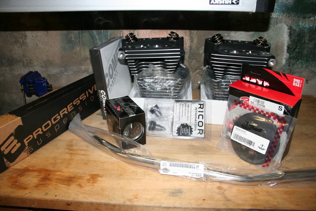

I've been waiting for this moment for a while now, since last summer actually when my trip to dyno tuning turned out to be a complete disaster.
http://xlforum.net/forums/s....php?t=1160247
Long story short, after >$700 spent at the dealer for the new cylinders and pistons the bike did not run any better than before. This pretty much confirmed what I suspected before; HD service has about the same rate of probability of getting the bike fixed that if otherwise I did the job myself.
After due consideration of whether I should go with SE setup or 1250 upgrade I decided for the latter. Having SE heads and pistons before I have to say that 11.3:1 compression is probably too much for NY weather and 93 gasoline, every too often I was getting loud clank and stalled engine after short stop at gas stations and alike.
So, ultimately my choice fell on Hammer Performance head work and 1250 conversion kit.
Along with the engine I also wanted to install a few other things and do some maintenance too.
Here is my plan for upcoming week (hopefully no longer):
1) Install Koso tachometer. The SE shift light that I have now turned out to be not working very well on 2006 carb model, too noisy. Hopefully Koso will work better, especially that they provide an optional signal adapter, which I expect to work better than directly connecting tach to coil wires.
2) Drag handle bar. I always wanted it, I hope my back wont hurt with it.
3) Ricor Intiminator with Progressive springs. My bike is >40K miles now, I figured I have to replace the springs anyway. While doing that I will also take apart the triple tree, not that I had problems with steering, yet it must be time to inspect and put some fresh grease on it.
4) Burnett clutch and spring.
5) And the last but not least Hammer 1250 kit and ported head. I already have .575 cams, so Dan sent me push rods that are supposed to go with it.
I am really excited about this work cant wait until tomorrow when I start.
Wish me luck, I'll need it.

I got all these parts, came out a bit pricey but a saved a few bucks buying on ebay. I will be very dissapointed if it does not function as well as it looks
BA551B22
BG004000
BE550M10
BE550M17
The billet housing was optional (especially for those how has fairing), but it should add a nice finished touch for my setup.
