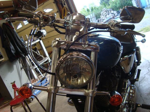

Thanks for the replies. I really love the color. Add in the big tank and wide rear tire and the bike looks more like a 'brawler' vs. a 'Sportster'. Time for some show and tell, I show, you tell me what it is.
First up, ignition module under the seat. Appears to be a Screaming Eagle 7k rev limiter module. The PO said when he had the bike at the dealers for service that they updated the firmware on the ECM. Not sure if this module is the ECM or it's hiding somewhere else.
Second, little plug in doodad that has a fuse and connects to the battery. Battery tender or?
Third are the handle bars and controls. I think they are drag bars, 27" wide and pretty flat. The controls are all chrome as well. I haven't noticed either on most stock bike pictures. The mirrors are '03 and earlier style replacement rectangles that are worthless with these bars.
I'm pretty sure the turn signals were relocated so they don't crash into the tank. Note that I bent the mirror stems to try and get them more functional, didn't work.

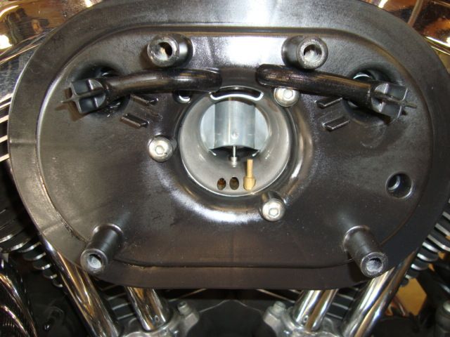

Finally, here's a couple shots of my air cleaner setup. For some odd reason I had a EFI emblem. I think the PO swapped air cleaners with his room mates '09 1200 and mine had a Screaming Eagle setup at one time. This base doesn't look like some of the others I've seen with the snorkel even though the chrome cover is cut for one. Do I have part of the S/E kit still installed?
Also notice the oil coming out of the breathers. This is after 400 miles of running. I figure it's blow by.
To help alleviate the draining effect of the original setup I moved the tubes so the oil has to climb out. Hopefully this slows down the oil 'draining'. I also put a little roll of blue air filter material in the tubes to help collect the oil from the blow by gasses. The oil will stick to the filter and drain back into the engine. I've had to do this to other vehicles in the past and it works pretty well.

Battery Tender connector "yes"
Worthless mirrors "yes" no matter what you do !
Screaming Eagle Air Cleaner "yes"
SE ECM is a "yes" probably flashed for a 1200 but the cams pretty much limit the engine to 6400 RPM

Cams... PO also said when it was getting serviced that the tech told him he thought it had a set and it pulled a lot harder vs. other '05 1200's.
Worthless mirrors... I have a set of these coming that should be here tomorrow. I'm going to machine them to fit the bike better and then polish them to death.
http://www.ebay.com/itm/251629794352...%3AMEBIDX%3AIT
For the A/C I'll probably leave it alone and just get another stock emblem. I chose the '04-06 to avoid EFI.
Other things I've noticed since I got the bike is the rear tire is offset to the right. The belt is tracking pretty close to the cover at the transmission. I expect to take it apart this winter and replace whatever has shifted. I also have a fork seal leaking a bit.
