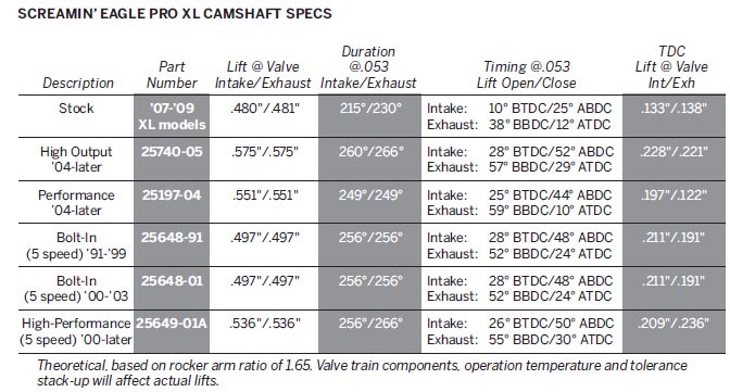

The SE "15" cams are marked 15-1, 15-2, 15-3, 15-4. They are the .497 lift cams, 4th and 5th down in this list:
They've been discontinued.
They were original equipment in a large number of tube frame Buell models.
Per a source at HD, they are literally the Andrews N4's, despite minor differences in their specs. The spec difference comes mainly from a slightly different rocker ratio assumption.
Consider the 505/515 grind to be a lower overlap version of the SE .497/N4. Because they have lower overlap, they fit a wider range of applications. For example, sometimes the N4 causes piston to valve contact when paired with stock 883 heads. That will never happen with the 505/515 grind due to the lower overlap.
Something you should be thinking about is the compression ratio of your motor, and the matching of the cams to it. A stock 1200 motor of the 91-03 generation only has a 9:1 compression ratio. That's pretty soft for the 46-48 degree IVC of the cams you're considering here. Expect a large drop in bottom end power as a result.
