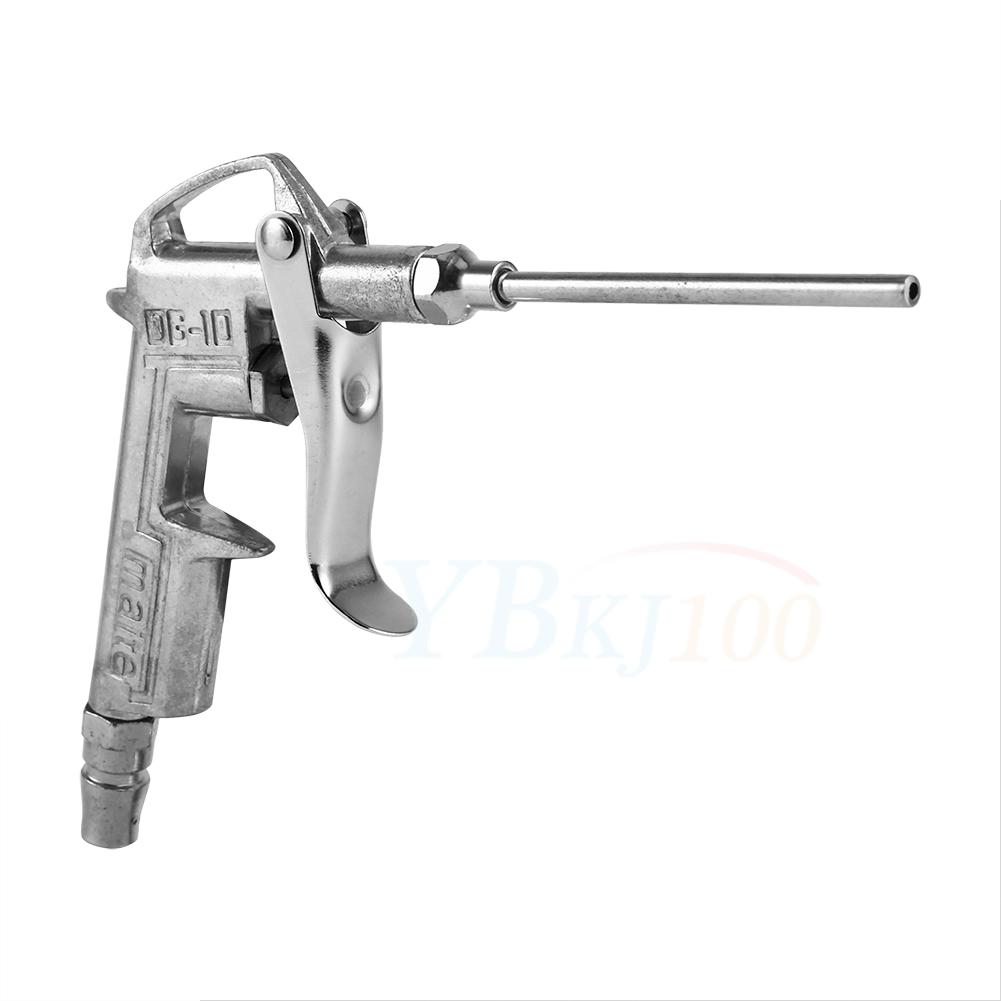

Originally Posted by AKC View Post
Well it was a real pain in the ass but got it done.
The 2 big pains were. One stripped hex bolt on the right side electrical/throttle housing.
And holy hell the glue they used on the stock grip left side! Royal pain in the ass!
But I managed to save the grip by using soapy water and a flat had screw driver and work the grip off.
Also. Upon measuring these so called 10" mini apes. When I leaned them against the wall and measured they are actually 11" rise.
It still worked but they were at the limit.
It took me just over 2 hours! But hey, $70 and a little time it saved me a lot of money
I've found compressed air to work like magic in getting old grips off of handlebars.
