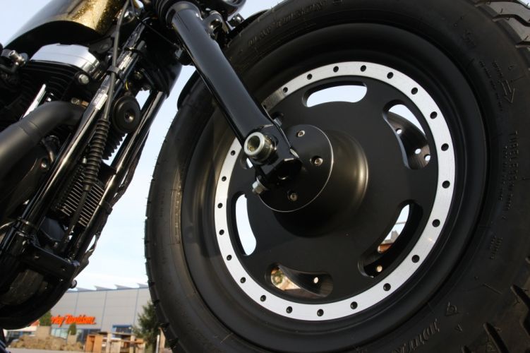

When I saw this thread it came to mind that I've seen pics of 48 with those wheels. Little google work and here it is: http://www.pinterest.com/pin/476255729316094230/
Looks nice

Yes!!! Thank you!!

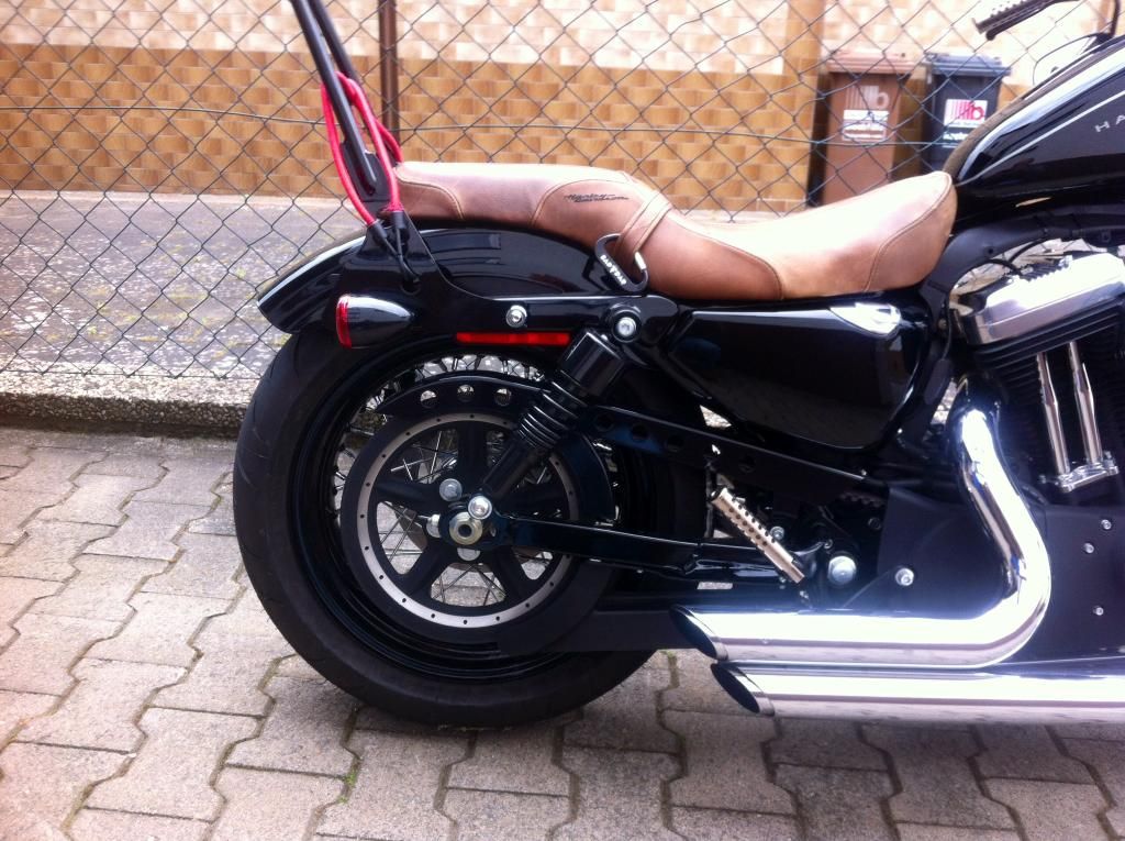

It will fir just fine. But you will have to go chain. I can say this because I have done the street bob rear on my 48. There is very, very little space as is. I don't see another half inch working with the belt. See for yourself
