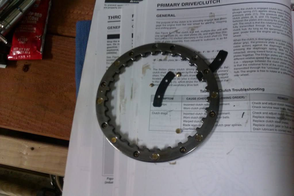

Plate from an 07. Shortly after my 1250. Maybe 20 ish thousand on the clock. Don't recall exactly.
Your photo looks all too familiar.
