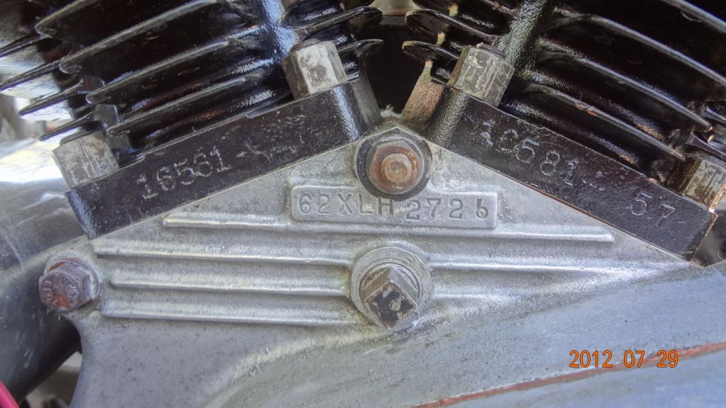

here is a pic of a vin of a 62 that i looked at not too long ago. kinda wierd, see the 2 different style of 6's ??

Cory those are probably legit. I have seen different font in the same number that were ok? Notice two different 2s also!

two different # 2 stamps and two different # 6 stamps but as long as the title matches.........

I think the general rule in the old days, was there weren't too many rules. Different stamp got used all the time within certain not too specific guidelines. So as long as the title matches....

Incidentally, the 62 photo once caused a certain forum member to say the numbers in it looked funky. But when I asked him to explain his comment there was no reply, just silence.

... Sometimes a two or three digit stamp was use for the year/model creating different fonts

Man, who would've thought that scoping old IH VINs would be so diverting? I really dig this thread--- the different 6s in the same VIN is so whacky--- half the time the Harley factory looks like it was just wingin' it... Amazing that dudes running those shaky but legit stock factory #s didn't get their bikes routinely impounded...

maybe the year and model were stamped in one part of the factory, and then the serial # was added towards the end of the line? the two stations had different stamps/fonts? the morning shift was still badly hung over when they struck the stamps on occasion, making their marks a little off?!...

Any possibility that say a batch of cases were stamped w/ the year and model just waiting to be assigned engine s/n?
Then the next guy to stamp the s/n grabs a block of slightly different stamps and stamps the last 4 or 5 digits?
