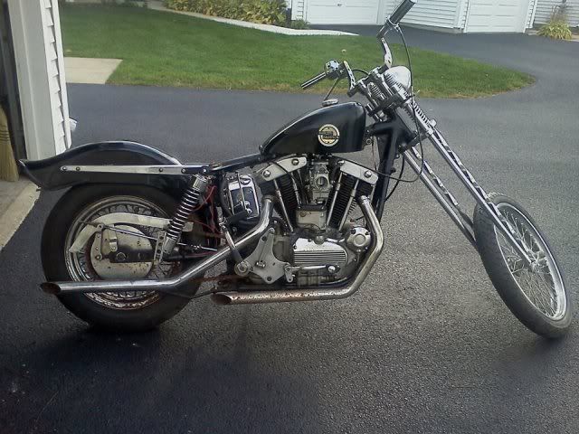

Here's another take on building a beefier custom sprocket cover for earlier models, from a piece of flat aluminum plate, presumably with spigot welded on and bushing installed for kicker shaft.
Looks very XR-ish and would look good on a bobber.
