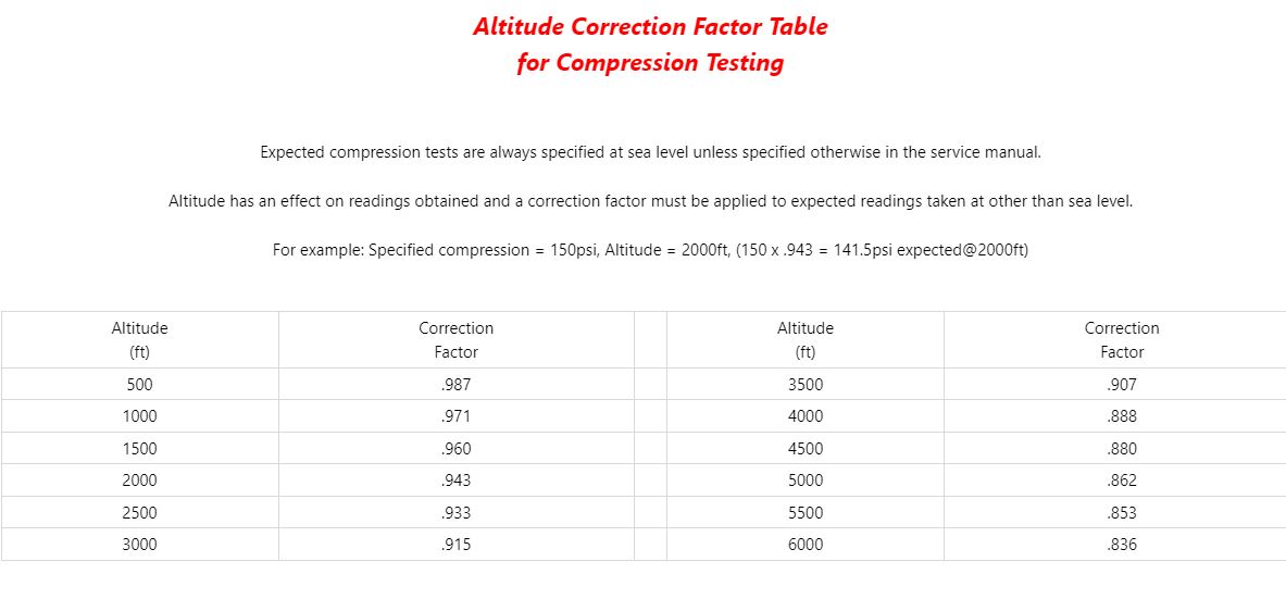

Often overlooked is the affect of elevation on the pressure.
The chart shows correction factors to adjust for altitude. As an example, I live at 1500 ft above sea level. If my bike tested at 150 psi at sea level and was re tested at my house it would measure 144 psi. (.960 x 150 = 144) That is a significant difference but the engine condition is the same.
Conversely you can divide by the factor to go the other way. (144 / .960 = 150)
If I measured 140 at home the reading at sea level would be 145.8. Personally I would be happy with that on a stock P cam engine.
I think many get too concerned with compression readings on street ridden bikes. Personally if I had 100 or better with less that 10% variation between cylinders, and the bike was running well I would leave it alone. Most people that test and expect to see 150 will be disappointed.
