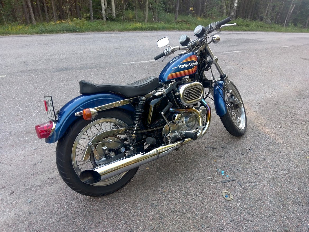

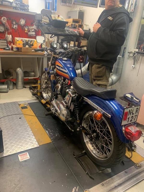

Default Dyno run XLH 1978
Engine: 1000 cc/61 ci, Andrews R5 cams, XLR valves, Manley valve springs, Wiseco pistons, heads ported.
Carburetor: 1978 Keihin 38 mm with little updates/Thunderjet
Air cleaner: Original Ham Cam 74 XL with KN filter
Ignition system: Electronic single fire
Exhaust pipe/silencer: Modified stock 1978 XL 2-1

Nice looking IronHead. Torque is sweet.
Great work.

Looks good!
FYI, for those used to seeing torque in lb-ft, that graph is in Nm
Multiply Nm by .737 for lb-ft.
Peak torque is 59.45 lb-ft when converted
I’m sure it will be a fun ride!

Very nice job. Approximately 1 lb-ft per cubic inch and approximately 1 hp per cubic inch. Good numbers for a street driven ironhead.
Would you be willing to post a picture of the exhaust? Thanks

That's an excellent result, great running Ironhead, congrats!

I actually like that view better as the lines don't cross.

The lines don't cross at 5250 if you measure in NM ?
I didn't know that.
I guess different calculations for torque ?
Also, I think HD claimed 65 horses for them back then. Always thought they fudged a bit.

Default Exhaust system
You can see that the muffler has been disassembled, what was inside it is removed and a perforated tube of 1.75 diameter and 12 inches long is inserted. In the tube are four pins inserted to act as "lollipops".

very nice,, 4 lollie s ,, good muffler,, and the right length around the cone cover ,, very nice,, carb combo and cams are spot on,,, ur a luckey man,,,ride and enjoy,,,im sure u did ur home work and than some,,, keeps me going,, thks for the info,,,
