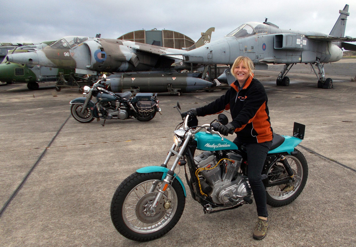

I was asked to post a thread on how I fitted Brembo brakes on my wife's 1998 XLH1200 street tracker.
The front caliper bracket was probably the hardest part, as the 34mm Red Wing HX road-race forks only had Ceriani-type fender bosses for support.
I chose to make both front and rear supports from 5mm stainless steel plate, and made a cardboard template to get the shape right before I started cutting the stainless by hand. The fork's 15mm axle acted as the lower support mount...
Once the rough shape was cut out, I bent the stainless in my 10-ton press to the contours I needed for the difference in lateral width between the inside of the fork's fender boss and the bracket's lower axle position - the bracket also acts as an axle spacer...
Once satisfied with the fit, I cut, drilled, and polished the support to take a 2-pot Brembo Goldline P32 caliper. This is usually a rear brake, but a combination of the narrow forks and Honda GL1100 rotor and hub meant the 4-pot Goldline P4 I originally intended for the front interfered with the spokes, so the calipers had to swap positions...
The finished and fitted front caliper, with genuine Brembo pads and genuine Brembo DoT4 fluid.
The custom-made stainless braided brake hose goes up to a 1996-up single brake Harley master cylinder...
Details of the rear brake to follow...

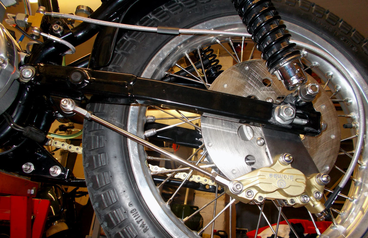

The 5mm stainless rear caliper support was much easier to fabricate - it just required a flat plate to be cut to shape, again using the card template technique avoid cutting mistakes.
Again, the support was drilled to take the 3/4" rear Harley axle, and as before the support also acts as a spacer...
The custom-made stainless brake hose goes to a brass Harley Shovelhead FLH T-piece (which also houses the rear brake switch), and then goes to a Brembo master cylinder...
The brake torque arm is made from stainless rod, with two 5/16" UNF Heim joints, the length of the arm is adjustable for different chain lengths...

As I said in my post, my intention was to fit the 2-pot in the rear, as normal, and the 4-pot on the front, but when I tried it, the front spokes were in the way.
Those 34mm road-race forks are very narrow, so spacing the rotor and caliper out was impossible, so I just swapped the two calipers over.
The bike only weighs 410 lbs unfuelled, and my wife's (and mine!) riding style is relatively sedate, so those Brembos are more than adequate - and much better than stock!
