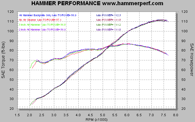

(same result with torque)
The bike is a 2007 XL883 (same as the one in the post above) with the following mods:
10.5:1 compression running pump gas. Shown with 4 different air cleaner configurations.
Discussion thread here.
