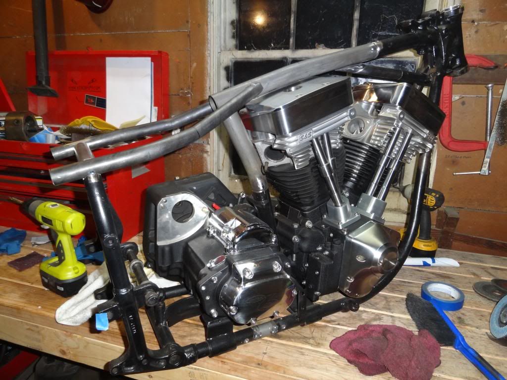

Nice! I will just make a custom caliper bracket.. It's actually being fitted to a 81 fx 4 speed frame that I have also fitted a 117cu s&s evo motor..
If I get time I will work on the rear wheel tonight.
This is what I have so far

Nice! LOVE that motor!
