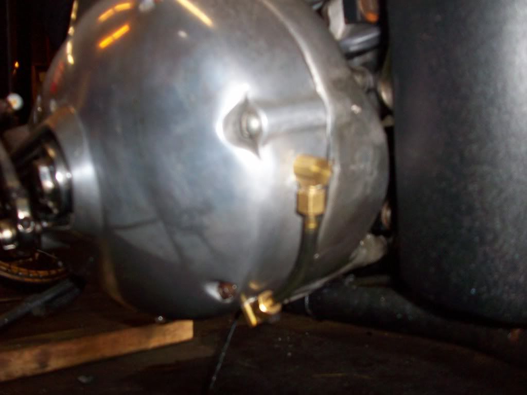

here's an easy mod for keeping tabs on the primary oil and it only costs about 5 bucks
I'm interested.
Please explain the mod or link to a post about it.
Cheap and easy that right up my alley.
WHATTSITDO????

here ya go hope it helps.
http://xlforum.net/forums/s...67#post2874067
