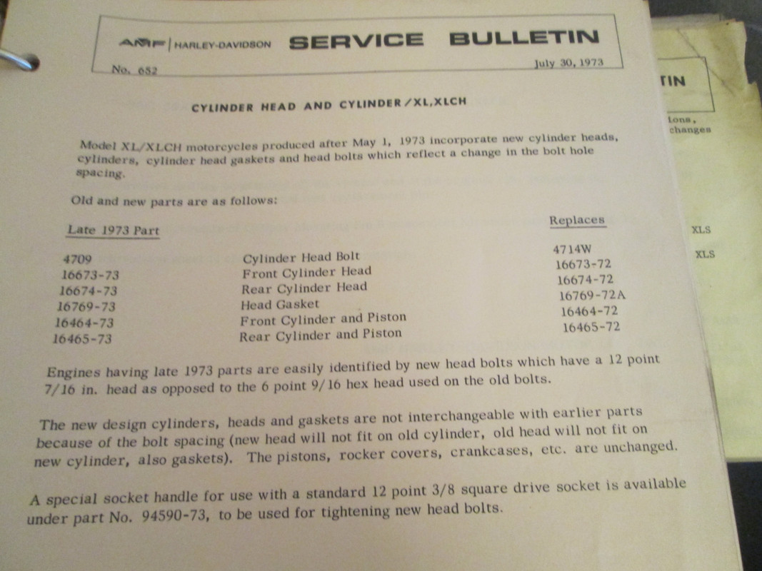

Originally Posted by bill smith View Post
You mentioned the sneezin, mine did that and once I rebuilt the flyweights in the ignition advance unit all was good. Pay ya to pull 'em out and service 'em.
Bill:
+1
Often overlooked.
TSB 652
MAY 1973
Easy check:
Early 73 = 6 point 9/16
Late 73 = 12 point 7/16
Old 27th September 2023
Posts: 16,444
Sportster/Buell Year #2: '03
Reputation: 2459311
^^^ thanks for the TSB 652 info sungod.i have a stack of them,i'll have to look to see if i have that one.
Old 28th September 2023
Posts: 16,444
Reputation: 2459311
my picture from my personal collection
