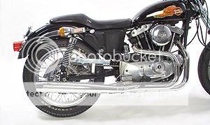

I think you can work out your forward controls around the Sportster Specialties 2 into 1 system. There is a gap between the 2 pipes and the front pipe is tucked way in.

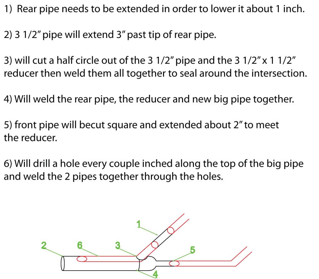

I guess aside from the cost, making my own crap is half the fun. so taking into consideration the replies I got, I'm thinking of not cutting the pipes down but making my own slip on/weld on deal.
This could work?

The picture from SS looks like the front pipe is forward and drops straight down. I suppose a call to the company they may know what is in store for mounting.

Anyone know a good site where i might find a reducer from 1 1/2" to 3 1/2"? I think ill probably need to use 2 reducers inline, should be fine have 12" to play with. Wife just said "You Wish" over my shoulder .

The front and rear pipe need to be as close to equal length as possible.
Biltwell sells a kit that will help you.
