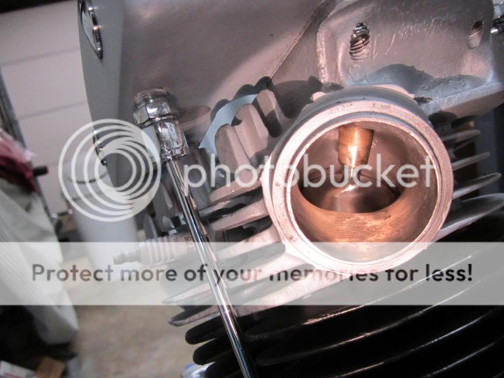

A mrmom ported 1000cc head 'laydown D shape inlet port'
