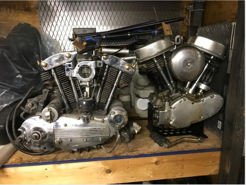

I scored a 1970 motor for $800, purportedly a "running non-smoker." I think it's probably true. The pan belongs to my bud in Maine who scored them both from a guy who is one of the biggest Harley hoarders in ME. My bud is building a Billy Bike, which is progressing about as fast as my 72. He's 2-1/2 hours from me and I haven't brought it home yet or even seen it in person. It's all bought and paid for and it's mine though. It'll be a hoot playing Then Came Bronson with it. I won't run it until I pull the trans out and check out that C/S boss, so I figured I'd finish the 72/1000 motor this year and look at the 900 motor over the winter.
