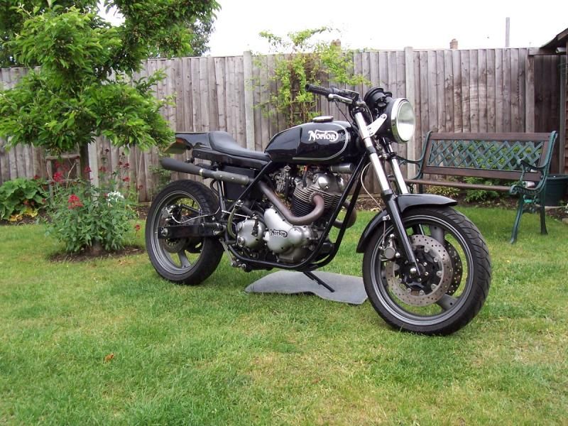

My Monoshocked Norton Commando Paul.
All Jap parts are from an 88 Yam FZR 600, ie - wheels, forks, yokes, brakes, swing arm and shock.
For some reason Photobucket have returned all my images today

Thanks chilly, nice bike, good to see it

That's a cracker Chilly. I can only imagine the looks on some faces.
