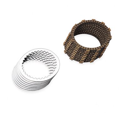

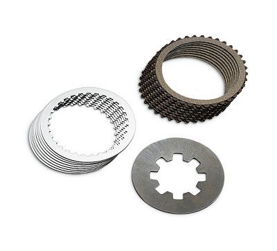

So, people who installed the 'SE kit', is it the # 38002-04 kit that you used?
What about the # 37980-10 kit? This is just friction and spacer discs (no spring); I guess you reuse the original spring? Presumably these discs are different to the # 38002-04 ones? The discs (only) from the # 38002-04 kit are # 38001-04.
# 38002-04 SE Performance Clutch Kit:
(clicky)
# 37980-10 SE Performance Clutch Friction Disc Kit:
(clicky)
I'm supposing these instructions were related to the XR1200 since they mention the damper spring & seat (not the spring plate)...
The friction plates have friction pads spaced apart while the 38002-04 kit has a continuous friction surface...
The 37980-10 install instructions say:
Remove the eight friction discs, six spacer discs, damper spring and damper spring seat from the clutch assembly following the instructions in the service manual.
NOTE
The spacer discs supplied in this kit must be used with the friction discs supplied in this kit. Do not use the original equipment spacer discs with this kit.
NOTICE
Do not reinstall the damper spring and/or damper spring seat with this kit. Doing so will affect the stacked height of the clutch discs. Failure to comply could result in premature clutch failure and possible engine damage.
37980-10 Kit comes with 9-Friction & 8-Steels (called spacer discs) ...
The instructions say the individual discs are not available...
https://serviceinfo.harley-davidson....5?locale=en_US
