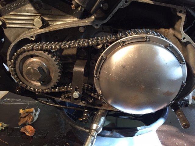

I'm going to try and add some visuals to go with Dr. Dicks descriptions in post #13. If I get something wrong or create confusion please say so.
The first pic shows a typical set up for an XLCH ( kick start) 1957 through 1969. Non hump case. Single bearing clutch basket and solid motor sprocket #40288-58 with the least amount of offset. Note the position of the chain relative to the edge of the clutch drum. A tin primary fits with this.
This pic shows a typical set up for an XLH (electric start) 1967 through 1970. Hump case. Double bearing clutch drum with ring gear. Compensating sprocket 40273-67. Outboard support for chain adjuster. Note that the chain is now moved closer to the outer edge of the clutch drum.
This appears to be a 1970 XLH. Still a dry clutch 900 with no left side VIN.
This pic is a 1970 XLCH. Hump case. Double bearing clutch drum and no ring gear. Solid motor sprocket # 40235-70A. Used on XLCH's 1970 through 1976. Also on late '76 XLH.
This solid sprocket with nut can be used in place of the compensating sprocket on XLH's 1967 through early '76 when the comp sprocket was discontinued.
