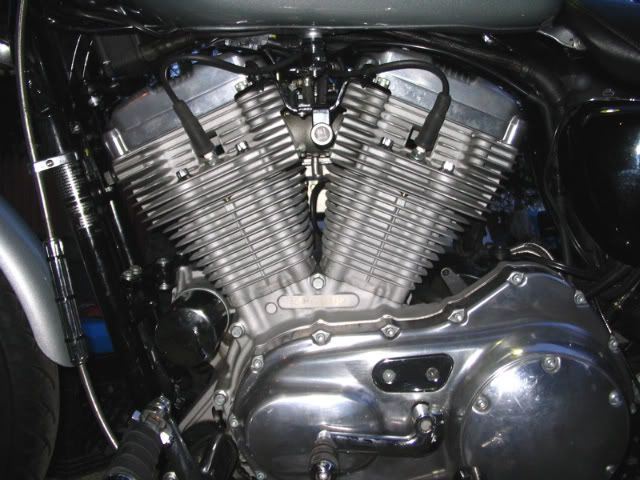

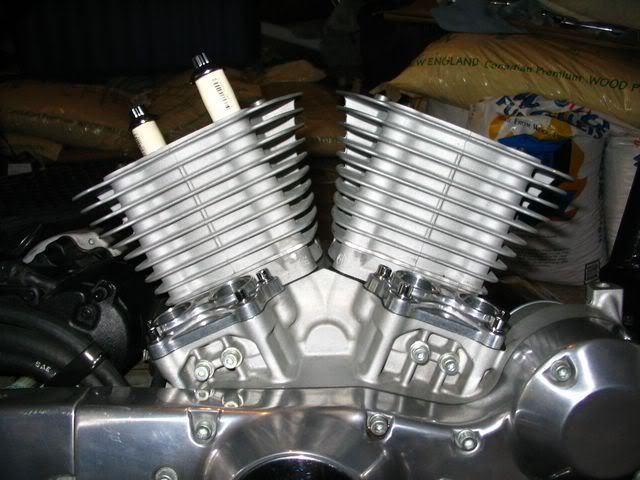

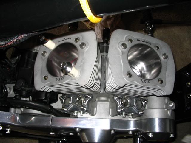

Yeah baby it's done! I did an NRHS 1212 conversion
on my Sporty. Just me, my factory manual, tips from NRHS
web site, and some great notes from some XLF members.
NRHS bored a set of cylinders I bought from XLF member
sportsterideragogo (thanks again Gary!), and I got the
10:1 reverse dome pistons with cometic top end gasket kit.
Kept stock heads, stock cams.
Thanks to everyone who contributed to the info on this forum.
It helped me a lot.
I put the bike back together on Friday and did the heat cycles
and the 20 mile ride between Friday and yesterday.
Tomorrow, XLF Member Racerwill who was actually going to
help me put the bike together tomorrow, will be helping me
get the float bowl screws out so I can bump the main jet
up. Other than that she's good to go.
Here are some pictures.
NRHS goodies
Disassembly:
Cylinders on
Heads on
Engine buttoned up
XLF Rules/Guidelines
XLF Guidelines II
1212 Conversion 10:1 CR
SE 497 Cams, E1 clutch, Python 3 Slip ons
TC88A running Xena's (brand new) White Tiger Map
My 1212 Conversion Thread
