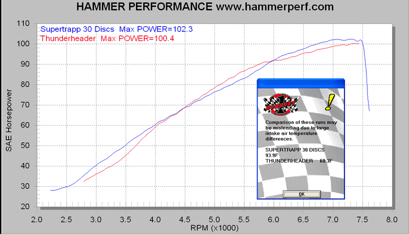

Thanks for testing the pipe for the xlforum and I Aaron. Looks like i will be using the 30 disc setup. Will have to find some longer bolts for it. The torque curve does look good. Im surprised how long it holds that 80 mark for. Do you think that the older style solid mount version being turned upwards would have any different results?
If you get a chance could you overlay the comparison of the 30 disc with your results on the thunderheader only because that is what i am.runnimg now. Looks like the supertrapp is a better performer all around over the thunderheader even though it pushed out 3 more lb's of torque in the middle.

Thanks for sending the pipe Mike!
Question for you: would you like a full map for 30 discs, and if so, can we keep the pipe another week?
I only did a full remap for 25 discs ...
(actual pic from the 25 disc mapping process ... that's as thorough as I can do it! those cells in the lower left are about impossible to hit)
For the 20 and 30 disc configurations, I cut a corner in the interest of time and I only remapped the right 3 columns, and I used the 25 disc map for the rest of it. If you're going to run 30 discs, I'd be happy to do the full map. But I hate doing this during work hours because HAMMER Dan is on the phone so much, and he can't talk on the phone while I'm tuning a bike. So I'd like to wait until Saturday, which means your pipe will ship back next week instead of this week. If you'd like us to ship the pipe back this week instead just let me know, the map I have won't be bad at all, it's just a full map would be better. Your choice.
With respect to the Theader/Supertrapp comparison, I'll put it together, but you gotta understand, you really shouldn't be comparing those two pulls. The bike was much stronger when the Thunderheader was tested, I've since hurt the motor and it's down probably 3-4hp from what it was back then (I haven't yet leaked it to see what's hurt). The T-header pulls were all 5th gear and these pulls were all 4th gear, too, and that makes a 1-2hp difference. And finally, I tested the Theader in the winter and now it's summer. Really, the only time you should ever compare two dyno sheets is when they're done same day.
But if you understand how invalid the whole comparison is, well, here you go ...

Wouldn't an end cap open just make the configuration similar to the Patriot or T-header with an internal baffle and open end?
And your dyno sheet overlay- are you insinuating that the Supertrapp would make more power if tested under the same circumstances as the T-header? Meaning, as good or better than the Patriot?
