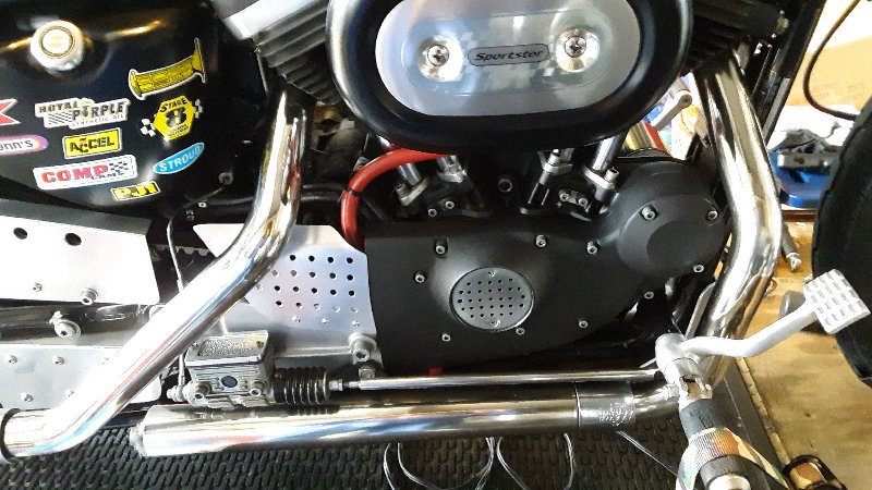

The rear pipe on rubber exhust presents a problem with a rigid evo...nose cone actually has the timing in it. It sticks out further than a rubber mount.
I have had to modify most 04 and above pipes ( no clue about injected engines ) to make the swap.
Yes, I had to subtly dent the inside of the rear pipe to clear the nosecone and remove the inner row of cleats from the rear brake pedal. They fit fine after doing that.
