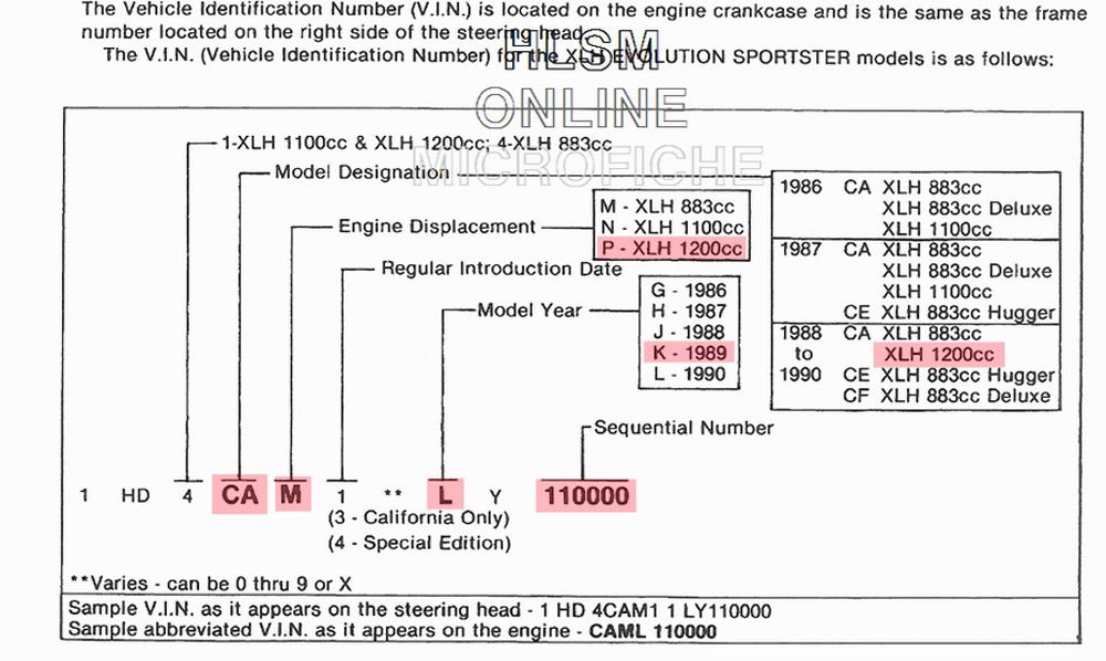

Default Evo Sportster motor VIN decode?
There are plenty of web pages on frame VIN decodes, but not much on the abbreviated VIN on the motor.
Can anyone decode this Evo Sportster motor VIN for me?
☆CAPK125584☆

All I can tell you is the CAP in your vin = XLH1200.

That's my thoughts too...
CA = XLH
P = 1200 Eolution XL
K = 1989

The last 6 digits should match the frame VIN as the production number for the bike.

Trouble is, I only have the motor, not the frame and title.
But I'm totally satisfied the motor is a 1989 XLH1200 - thanks to all.
Copied this from Ronnie's HD webpages... http://partsfinder.onlinemicrofiche....20MODEL%20INFO
