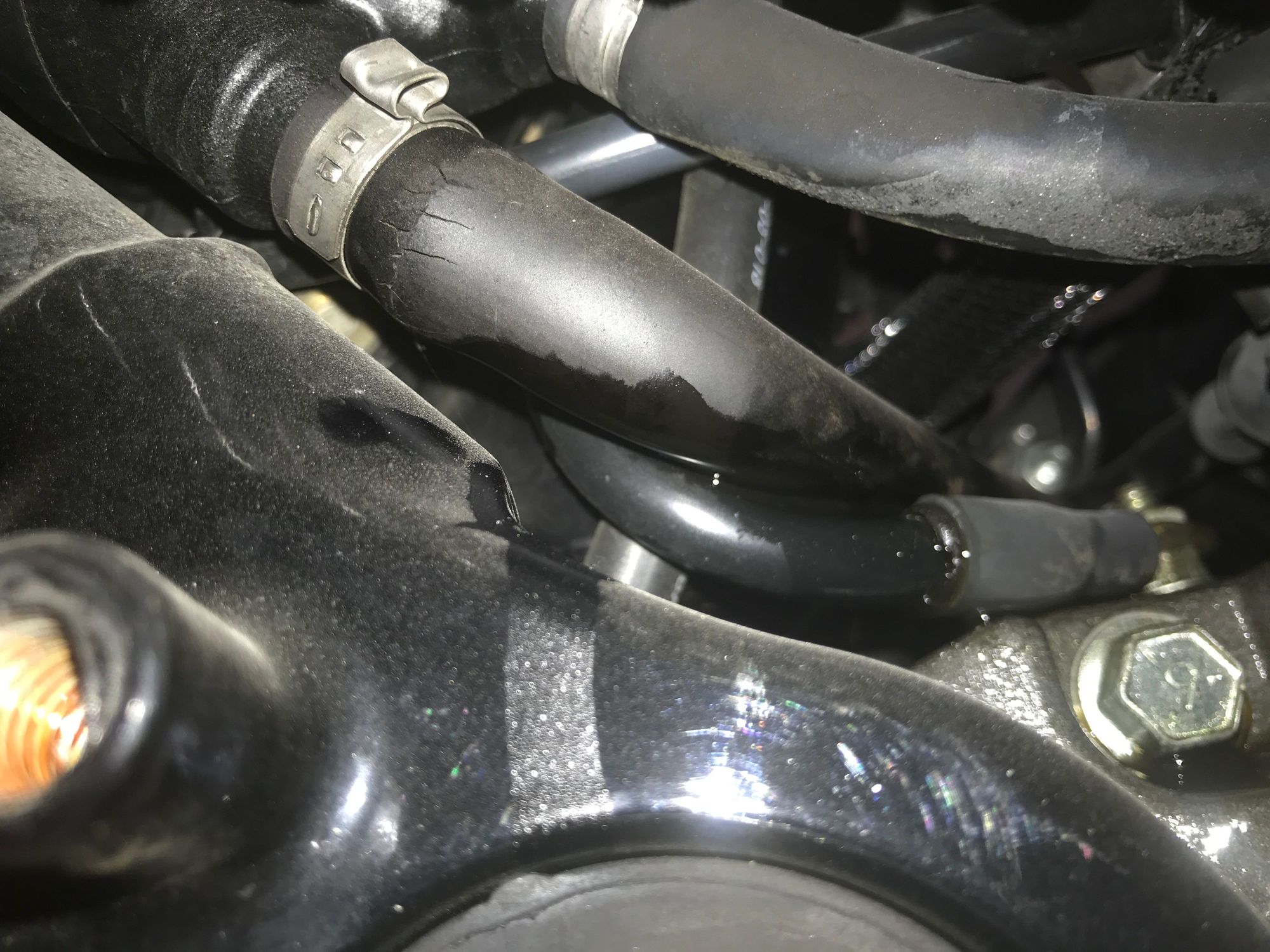

Default Oil Hose replacement help.
so in all honesty this seems pretty straightforward. theres a sleepless clip on one side. and the other is free to move but when i pull on it, it comes out about 2.5 inches to here;
and then i get resistance. can i just pull it out? anyone ever taken one out?
Also, whats it called so i can order the right part to replace it with.
heres some more pics;
Old 4 Weeks Ago
Ireeman's Avatar
Ireeman Ireeman is offline
Asgardian
Location: Deck of Me boat
Posts: 7,672
Sportster/Buell Model: 883r
Other Motorcycle Year: abov
Reputation: 4945202
Sleeplesclampon needs of rid of.
Dis is factory furging frumxxxxinshit.
Discard and replace with proper accessible hose clamp's . Double clamped per hosing end.

That’s your oil bag (tank) drain hose I believe. It fits in a sleeve through the case and under the bike there is a plug and a hose clamp used to drain the oil. You will need to remove the clamp and plug, drain the oil and cut the clamp off to change the hose. I have the crimping pliers so I used the same type clamp when I changed mine. I suggest a fuel injection hose screw clamp so the clamp won’t eat the hose when you tighten it. May want to get two clamps and replace the drainplug clamp also.

Here is a link to Ronnie's HD parts fiche for the oil tank for a 2008 Nightster-
http://partsfinder.onlinemicrofiche....%20W/%20FILTER
2013 XL1200C
Find your Owner's Manual, Wiring Diagram and Parts List here :
https://serviceinfo.harley-davidson....cle/lookupForm
Enter your VIN OR
Use the search - enter year and model
If something doesn't work on your Sportster look here:
SportsterPedia.com
Old 4 Weeks Ago
McQueen McQueen is offline
Join Date: Apr 2018
Posts: 4
McQueen is an unknown quantity at this point
Thanks! That’s it (#22). Very helpful!!!
