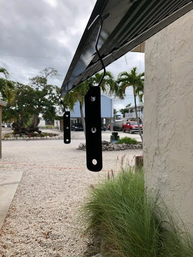

Default made a couple sets of front fender risers
had to clear a 130/80-19 Dunlop K180... I think a 110/90 would clear...
These are gonna dissapear painted black and will do for now. I'll try some other things later... 0.065 6061-T6

How are you blanking the sheetmetal, laser?
I have no patience for body work or finish carpentry.. I may however paint the tank, oil tank, and ignition module cover myself.

Roger.
I was noticing the shock/fender brackets and got curious
Good parts.
Roger.
Good parts.
made the fender brackets on the mill and then used a belt sander to radius them... the shock mounts were drilled on the mill then cut out with a cutting wheel and then shaped on the belt sander...
