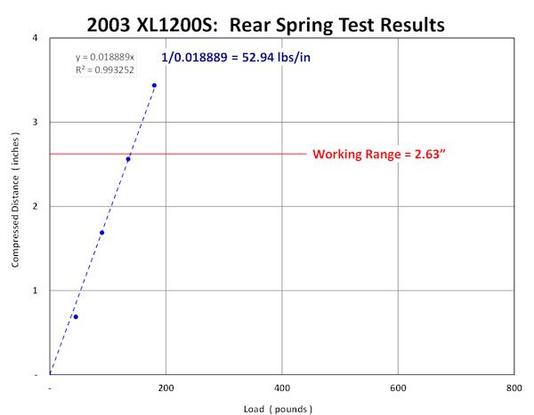

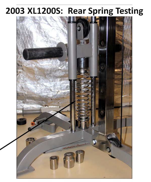

Getting the right spring rate is 90% of the job, in my experience. If that's not right, then no amount of damping adjustment is going to make the ride plush.
Agree 100% on the spring comment.
The S shocks are good. Common wisom is that the springs are too soft for a rubbermount, but, on bumpy city streets, who knows? They may not be far off what you need. With the short forks, raising the rear is going to throw a bit more weight on the front, therefore less on the rear. It's a balancing act.
What is good about the S shocks:
- Longer
- Adjustability (compression and rebound)
- Rebuildable (I think)
I have disassembled one and tested the spring - 52.94 lbs/in!! It is the weakest spring I have ever tested from any bike. My 86 Honda VF700C had rear 97 lb/in springs and they were inadequate. XLXR, you are right on about the weak springs; but that's why you replace the springs to what you need. The S shock is a good shock once you get the right [Eibach] spring on. On this point I would be interested to hear from anyone who swapped out springs and what their experience was.
Some early XL1200S test results:
XL1200S rear shock disassembled
Spring testing using home gym equipment
Test results
Bad about the shock = price.
Jerry

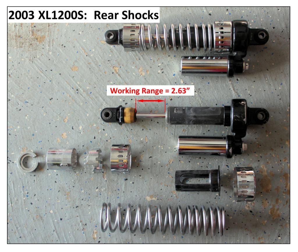

XLXR,
Since you commented on the S Shock, here are a few more items that back up your comments on how weak the springs are.
In the first pic, you can see the suspension strategy for the stock shock using the weak spring. The free length of the spring is a tad over 10" (10.125"). Once mounted in the shock, its mounted length is only 8". That means the spring is compressed a little over 2". With a 53 lb/in spring rate, that gives you a 112.5 lb preload - and you have 2 shocks. You can dial in some additional preload, but thats it. For a lighter weight rider, that might be enough to set the initial sag but that's it. The spring doesn't have enough top end capacity to prevent you from bottoming out.
In the second pic, I show what the spring capacity is with no additional preload dialed in. This is the blue line with the "1" on it. You can see it starts at 112.5 lb preload (from the spring mounting). As you add more weight to the spring, it begins to compress until it get to the working range of the shock (2.63" later). The total capacity is 252 lbs. If you dial in all the shock preload, the # "1" line moves over and becomes the # "4" dark blue line. Compressing the spring with all the shock preload yields a max capacity of 282 lbs. That 30 lb extra capacity is only about 12% more capacity. So, if you have these shocks and weigh anything close to an average man, you need all the preload dialed in... but I bet you still bottom out alot. So the strategy is clear if using this shock, you will have to swap out the spring,
I'm going out to the garage to do some more baselining and will report back with more pics and graphs. The data from the bike will help me determine what rate spring I need.
Pic 1:
Pic 2:
Jerry

Is that your shock spring tester? That's not something average Joe has in his garage. Who the heck are you?
I am not sure why your measurements are not getting into the final spring rate, which should be around 85 lbs/in. If you can't get into the final spring rate, my guess is the springs are already worn out. If the springs are worn out, throw the shocks away, the hydraulic oil and seals/bushing are probably also worn and probably not worth the effort or expense of new springs.
Another problem with the 1200 S shocks is that as far as I know there are no replacement springs available, and no rebuild service available. Maybe there was in the past, but not now. At least, I am not aware of any. Just because the shock or spring has a well known brand name, does not mean replacement parts are still available. Harley specs out there own dimensions, which probably do not cross over with anything else that particular brand made. Sometimes shocks are press fit together, and are not rebuild-able.
Even if you could swap out to a heavier spring, which would be closer to 75/120 lbs/in, I doubt the dampening curves will match that big a jump. I have had a lot of dirt bikes, Ducati with Ohlins etc with adjustable shocks. I still have a set of 3 way adjustable WP shocks, the European company sitting on the shelf. Ricor inertia technology makes cartridge/shim stack technology obsolete, until you start spending a whole lot more money.

2" ID [Eibach] springs are easy to get. THe other items are too, just takes a little effort to source them.
I have not had an experience with Ricor products - yet - but we shall see. BTW, I cannot find any info on them as far as rebounding damping. There is lots of material out there on the compression side but I am most interested on the other side. Can you help me find this info XLXR?
