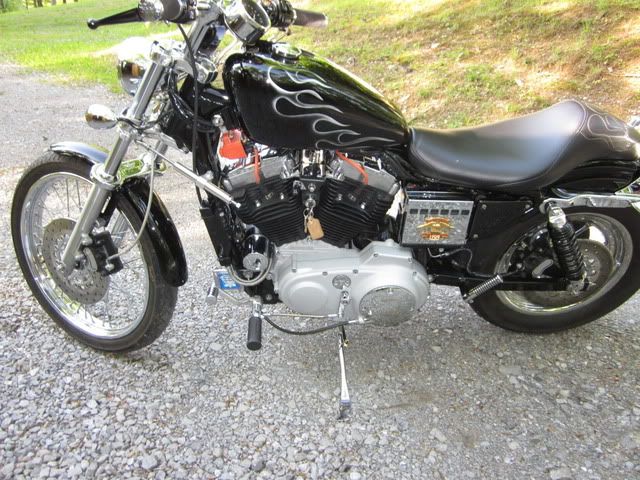

I bought the same kit, the coil mount just replaced the stock bracket in the same location. The black bracket fits the screw mount of the key switch. I pulled the tank, moved the key switch wiring down between the cylinders and mounted under the top motor mount / choke bracket.

Here you go;
See keys hanging under choke / engine mount.
