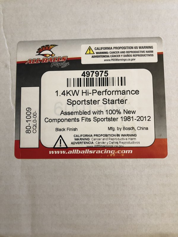

Thank you for the feedback. I purchased the starter 1.4. hopefully, it will show up by the end of the week.

Today I received the All Balls starter. This is the report test that came with, in case someone may want to look at it!

sportsterdoc has a reputation beyond reputesportsterdoc has a reputation beyond reputesportsterdoc has a reputation beyond reputesportsterdoc has a reputation beyond reputesportsterdoc has a reputation beyond reputesportsterdoc has a reputation beyond reputesportsterdoc has a reputation beyond reputesportsterdoc has a reputation beyond reputesportsterdoc has a reputation beyond reputesportsterdoc has a reputation beyond reputesportsterdoc has a reputation beyond repute
At the 9 volt test (battery should not drop below 10.5 vdc, generally) it would draw 164 amps, after initial in-rush (1480 watts / 9 volts).
475 amps would be locked rotor, such as motor hydrolocked, etc.
