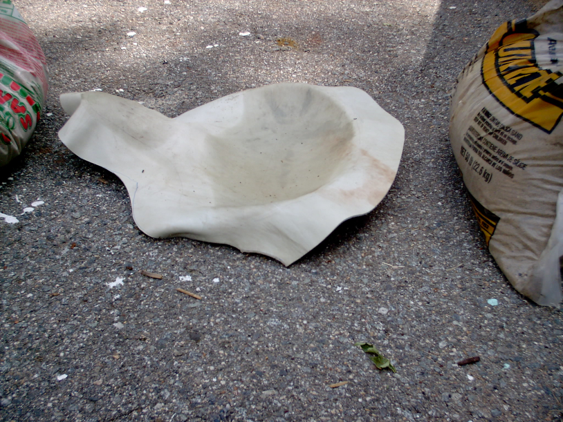

Had a brainstorm. Was thinking I would have to wet the leather and sit on it forever in order to get it to conform to the pan. What I did was soak the leather in the sink for 10 min and put a couple of bags of sand on it overnight to get it to conform. Now it's drying in the sun. It's chrome tanned and actually shouldn't be conformable, but it does work. Previously I had made a practice boot toe to see if it was conformable and it sure is. Ordered the rivets for it this morning too. Last winter I brought home an old dining room chair for firewood someone was throwing out. Turns out the cushion was cotton batting. That should be more correct and should look more genuine and be easier to work with than foam. Of course it will be harder than thick foam, but I have both seat post springs and shocks, so I'll try this anyway. Bike is still under the tarp awaiting my attention. I got freaked from the money spent and stopped working on it.

Glad you’re back on track. Good idea wetting the leather.
