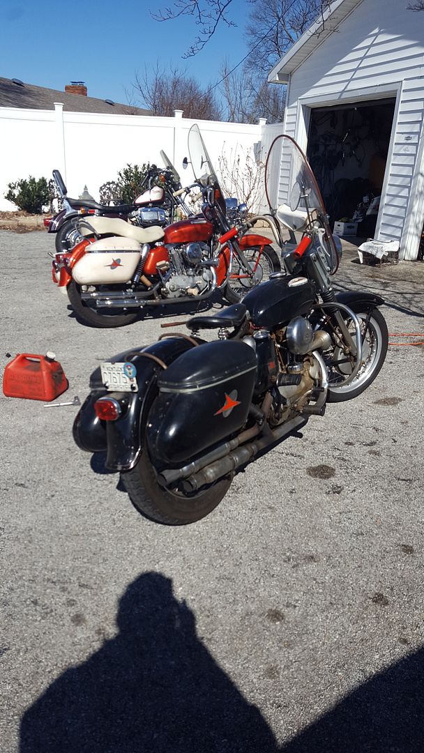

Having trouble starting this bronze 61 xlh, it has the super E, it will start with starter fluid, but I cant get it to start without it

Is it possible that the carb is gummed up from sitting with fuel in it, or has it been thoroughly cleaned recently - completely dismantled? Does it do anything (pop, fart...) without starting fluid? Idle screw adjustment set too low? Do you use the enrichener (raised position) when attempting to start it? With the air cleaner off, if you twist the throttle, can you see it squirt fuel from the accelerator pump?

That iis a nice sporty collection.

CCP?
Idle quality is?

no fuel squirts from the accell pump when I twist the throttle, however when it started with the starter fluid, it ran and ideled great and also did not pause when I accellerated

Is it old fuel and what grade?Also with a mag wonder what kind of spark your getting and when your getting it.The spray is addictive had a old Oldsmobile that wouldn't start without a lil spray,Hope you luck.

What about the enrichener, on or off? On always helps starting a cold engine. I’d say pull the carb apart and soak it in a gallon tub of berryman’s or gunk overnight, then pour boiling water over and through the parts, reassemble and see if there’s any change. No squirt from the accelerator pump says either the pump is “shut off” with the adjusting screw, or the passage is gummed up with varnish, in which case the rest of the carb is probably in the same state.
