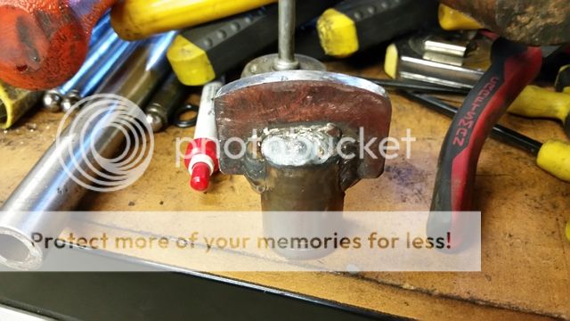

And this one last week.
Sent from my SM-G928V using Tapatalk

Nice tools Tribulation.On the clutch tool I made the flat stock long enough to come past the crank shaft sprocket drill two hole for holes in crankshaft sprocket to match but mind was a XLCH and didn't have the compensating spring as electric start may not work for you but it locks everything up.Plus I used a bigger all thread and pushed in on center of clutch basket.Double nut it on the end so you can screw it in.
