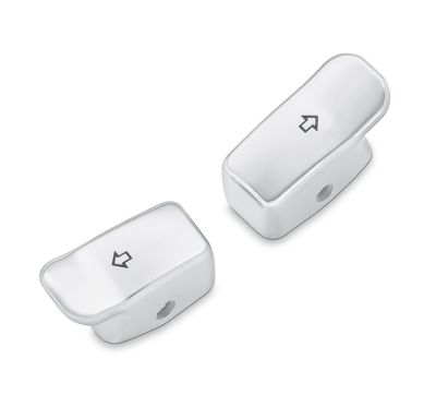

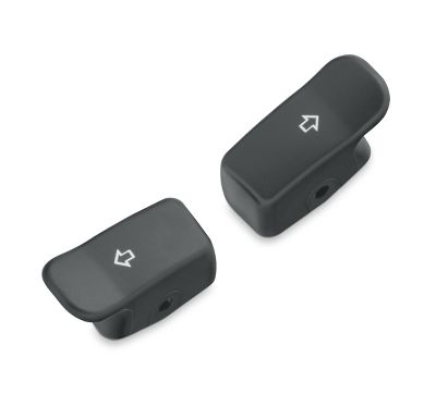

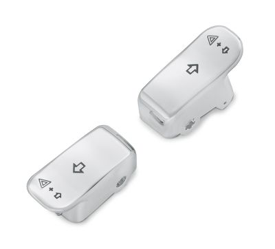

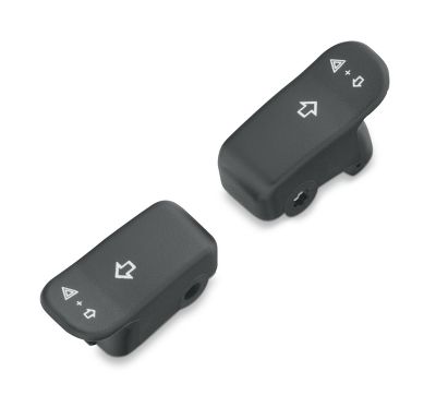

I imagined you'd just look on the H-D site, but here you go:
(clicky) (clicky)
Those are for '96 - '13 bikes. For anyone wanting them for '14+ bikes, there are different ones:
(clicky) (clicky)

Folkie,
Thanks for the info and pics. I didn't know they were actually H-D parts and not aftermarket or I would have looked there. I appreciate your extra work.
As for the metric turn switches vs the H-D self-cancelling switches, I ride both styles right now intermittently right now and I have to say that because of having to manually cancel the metric signals, I'm constantly watching the dash of my Sportster to see if it self-cancels. In my case, the self-cancelling feature doesn't really help me - they work but I just worry about them which is just as bad as having to manually turn them off. I guess I'm just too OCD.
