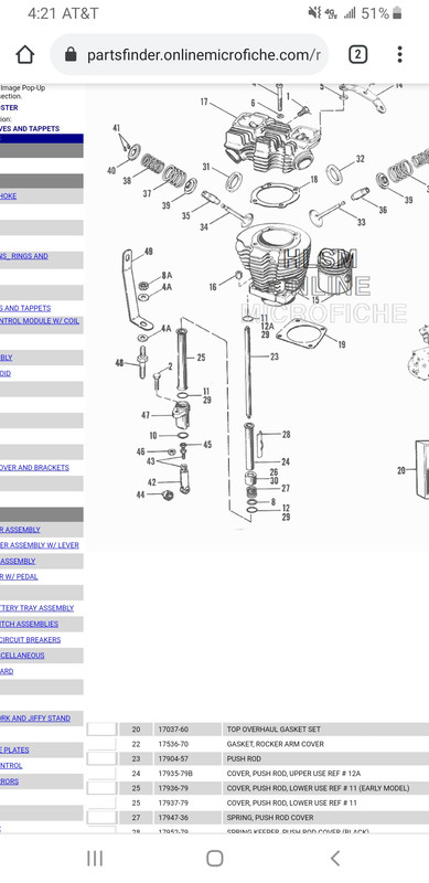

I saw many times the fact that the oil leaking is only at high speed or high rpm. There is pressure issue?? Or only block groove.???

just return from the bike and see that is free play when I touch the cover of pushrod I can rotate from side to side . mybee this is the reason for leaking bad spring

That could cause some sealing issues I reckon, supposing that this is actually the source. I saw you mention that you replaced the upper and lower seal with one from a hardware store. Did you also replace the middle seal?
[IMG]https://i.postimg.cc/NfSGjWZ8/Screenshot-20200908-162104-
Chrome.jpg[/IMG]
no, I can't find the middle o-ring shape its different shape

Ok, well I don't have one as new as yours so maybe they changed that at some point. I was pretty sure that the corks I replaced were all the same.

still leaking after install new kit of o-ring and cover pushrod all from jpc cycle
what should I chack more ?? still free play of cover that's ok????

Up and down freeplay after assembly?

no free up and down play
