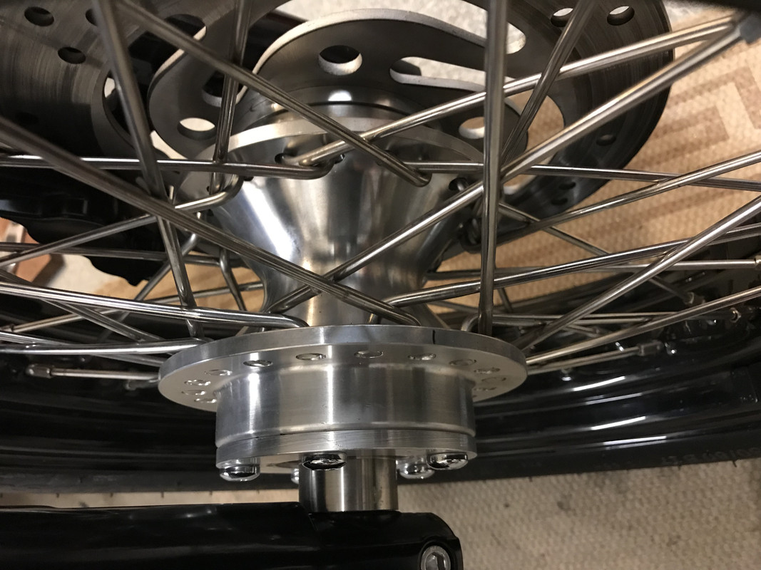

Narrow Dyna hub to mid-glide
Axle spacers made to suit from stainless
Hub spacers made from Aluminium, one to space the disc out and one to blank off the rhs.
Hub laced to 17" x 3.5" rim

This is the hub I'm using. It may be the same as yours.
