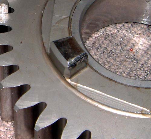

Replaced both first gears and took care of the problems and the wife is happy. Was a pretty easy fix, took about an hour and half to do the job. thanks everyone

Again - excellent pictures -worth at least 1K of words.
The jumpimg in and or out of any gear is primarily due to the condition of the leading and trailing shoulders on each dog pair.
As the shoulder(s) become rounded off from slow shifting or grinding shifts the angle of repose (zero rake angle) drops away from a pure 90 degrees. This slight angle will alllow the radial forces (i.e. torque) to be converted to axial or side forces that can not be resisted by friction or the shifter fork and pawl dedent spring.
In high performance e.g.turbocharged engines or other racing applications the builders will often do a " negative rake" cut or machining so there is a side or lateral force that pulls the dogs togther and insures - for the most part - that there is no chance of a gear jumping either i) out during acceleration or ii) out again while in de-acceleration from down shifting.
Gear popping only gets worse with time and with each time it jumps - never better. That is why, not unlike voting was in Chicago in the 1930's, it is good to " shift often and shift hard".
I hope this helps to explain the most common cause of gear jumping when the adjustments are correct.

Originally Posted by beuz View Post
I HAD TO REPLACE MINE....(the one on the pic).
here are all the part numbers you'll need :
No differences in the gear box between 1996 and 2003.
Which parts exactly did you replace?

My gear first-countershaft (P/N 37763-89A), as shown the the page 1 of this thread.
[B]
Second gear on both the mainshaft and countershaft changed in '00, as they changed the second gear ratio.
Here's some pics of worn dogs, this is what mates with the gear pictured above:
